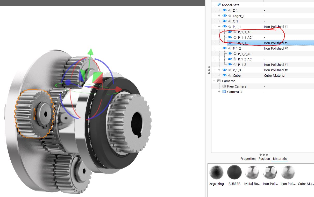

I’m creating a render of a gear system where the gears:
  1. rotate around another object (named AC)
  2. rotate around their own axis (named A0)

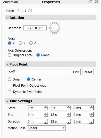

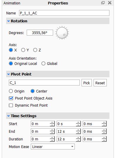

if i only enable (1) it animates (1)
If i only enable (2) it animates (2)
If i enable both it only animates (1) and not both.
What can cause this?

I was able to find the issue. No need to upgrade, it is not a bug.
In this particular combination of rotations, the rotation of the gear on itself is compensated by the rotation of the gear around the pivot, such that the rotation of the gear on itself becomes near imperceptible.
If you change the angle values for one of the rotation dramatically, you will start to see that there is a rotation of the gear on itself. For example, change the angle value for P_1_1_A0 from -12510 to -50000, then play the animation, and you will see that it is indeed applied. Alternatively, scroll to the end of the animation, then disable P_1_1_A0, and you will see that the gear jumps to another rotation.

Great tip, i’ve added a checkered material on the gears and now i can clearly see the rotations happening. As for the two rotation animations, they can’t cancel eachother out since there’s factor of about 3,5 between the rotational values of AC and A0, but i suspect the following:
When putting the material back to metal, the only visual aspect that we as viewer can judge the gears rotation off of, is the position of the teeth of the gear. What might be happening is an effect where the change of position of the gear divided by the time between each frame, is about equal to the angle between the gear teeths. A cool example is this in real life; camera shutter speed and frame rate match helicopter`s rotor (youtube.com)
